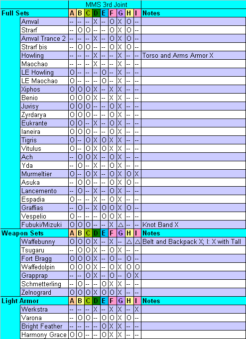

MMS 1st Body to MMS 3rd Body Issues
Using the list of joints above, please use the following chart to see which parts are compatible between the MMS 1st and MMS 3rd body.
O=Compatible X=Not Compatible
1st to 3rd.gif (2.44 KiB) Viewed 22083 times
※Due to design considerations, some combinations will not result in pretty lines.
Shinki Compatibility List
Following is a chart of MMS 1st style Shinkis. Please use this chart in combination with the above list.
O=Compatible X=Not Compatible △=Limited Compatibility

looks like all the old shinki leg armors at part "D" are not compatible with mms 3rd :?
thanks for the chart :thumbsup:

Looks like I'll be needing to track down MMS 1st or 2nd bodies for Tsgaru and Schmetting, as Tsugaru would probably require somehow bypassing the issue with the lower legs by simply subsituting the entire leg units, which is impossible without any spare early compatible legs to start with, along with looking really strange (although I don't own her set, so I don't know what goes at points D and G, but if they would look tolerable with the tall body, then I might reconsider) and for Schmetting, while she'd be better off short to justify why I even want her, she aparently can't use her back butt bow and chest plate, which is a pretty sizeable part of her set since she's not got much.

Lockdown72 wrote:Looks like I'll be needing to track down MMS 1st or 2nd bodies for Tsgaru
if you can find the Sky Girls mms figures i used one of those(Otoha i think was her name) with a tiny bit of exacto knife work to fit everything together. ended up being decently cheaper than buying a naked for me.

Hmm, so this means Fubuki and Mizuki won't fit with mms 3rd tall? I got messed up bodies for both (what are the odds...)
