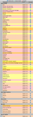

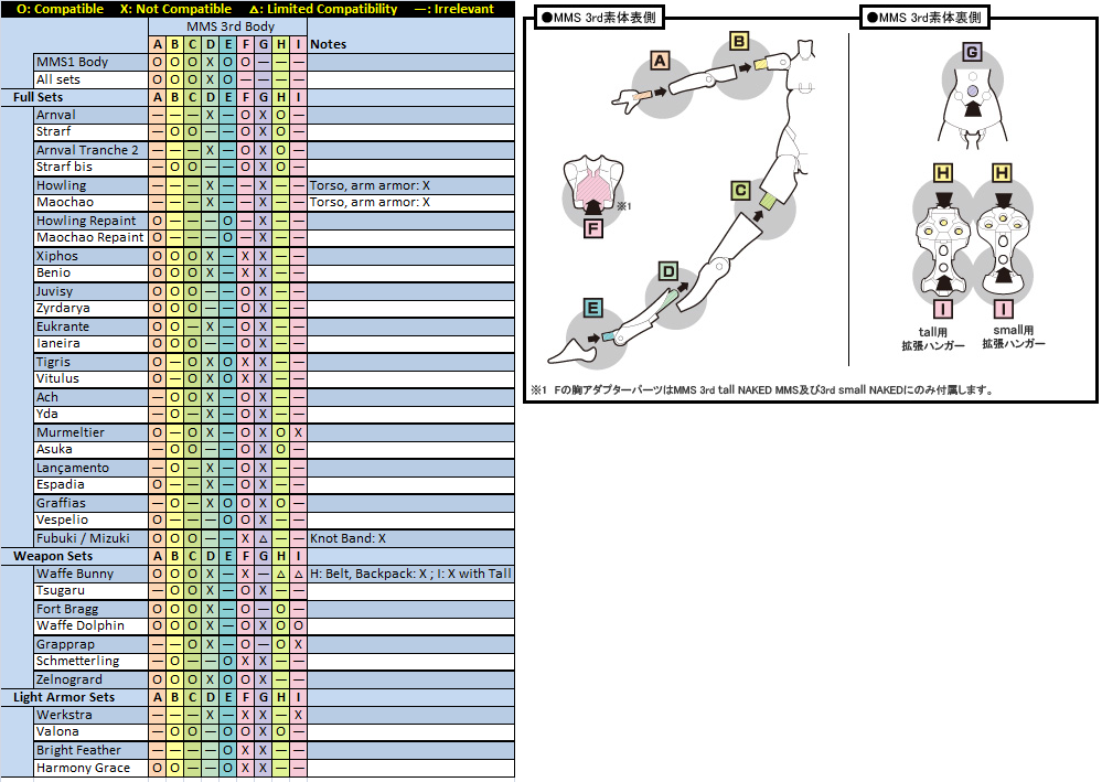

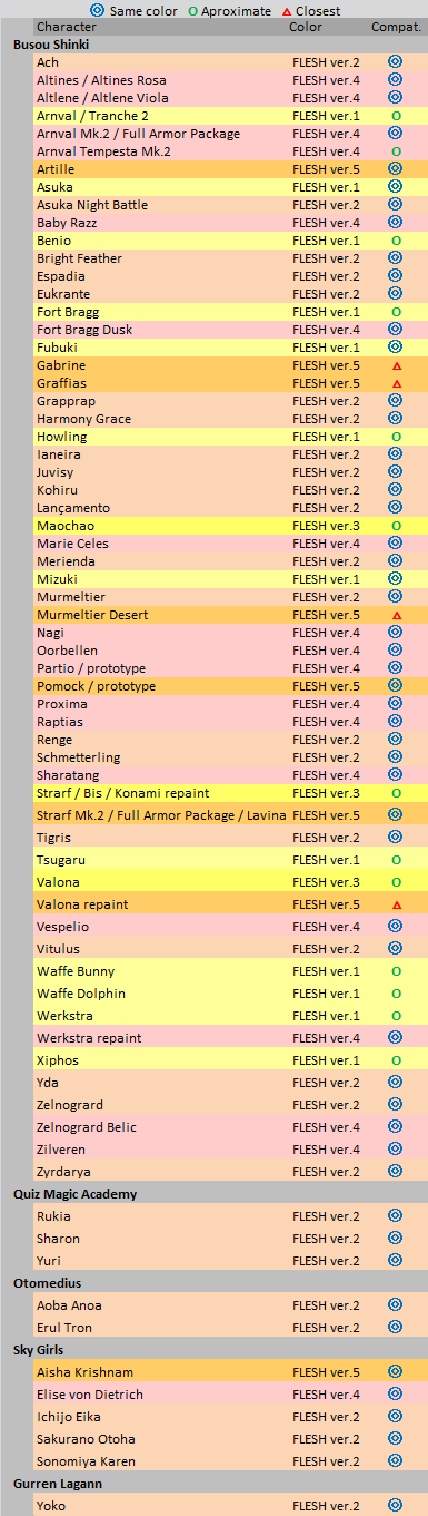

Since all previous attempts are outdated, broken, or plainly weren't as efficient as I expected, I've decided to make my own charts, and here I'm sharing them with you.
There's a "MMS1 vs MMS3rd" joint and a skin tone compatibility chart.
The only one that will need updating is the skin tone chart, as new MMS1 figures aren't released anymore. I could include MMS2 figures on the joint chart, but it'd take a massive ammount of research and would require every single MMS kit (except for copy parts, like with repaints), so I won't. The same goes for trying to fit a MMS3rd kit onto a MMS1 body.
If anyone can translate the Japanese text on the joint chart, please do.
The skin tone chart does NOT include the non-Konami exclusives for now, like Dengeki repaints and Wonderfest exclusives, but also stuff that isn't mentioned in the official chart. Unnoficial Shinkis may be added, including CHOCO's heads.
I need your help for this, but please no color blind :P, and you must have in hand all 5 body colors to compare.
Skin tones needed:
Arnval Dengeki
Strarf Dengeki
Howling Dengeki
Maochao Dengeki
Ach Stradale
Yda Stradale
Oorbellen Garnet
Oorbellen Lunaria
Zilveren Sapphire
Zilveren Amethyst
Alastore
Kyknos
Official skin tone chart last updated: Sep/2X/2011 with Arnval+Strarf Mk2 Full Armor Package. (If there's a more recent change, please tell me, but I'll look at the chart every time a new Shinki comes out)

Postby GundamShinki » Mon Jul 29, 2013 7:26 am
Not sure if you are aware, but the Full Arms Arnval & Strarf psp are a little darker shade then the Non Full arms psp versions. I am unsure if the Tempesta and Lavina models have same issue between f.a. and non f.a. Does effect exact coloring vs close. Just trying to help since I have had all 4 psp versions.
I am adding a link to show what I am referring to
http://s1320.photobucket.com/user/Gunda ... sort=3&o=1
http://s1320.photobucket.com/user/Gunda ... sort=3&o=0

Postby Aurea Arleigh » Tue Jul 30, 2013 3:00 am
The Tempesta vary a little in color too, always hard for them to keep their colors the same. You will also notice small detail as eyes of these models are slightly faded or more darker depending on your version.
Aurea Arleigh
Posts: 139
Joined: Thu Apr 04, 2013 9:36 am
Re: MMS Body Compatibility Guide
Postby Aurea Arleigh » Tue Jul 30, 2013 3:04 am
Also to note I did not see Mizuki or Fubuki Type 2 ninja, they are slightly different from their original models not sure of exact color but they are less pale.

Postby Aurea Arleigh » Tue Aug 27, 2013 5:52 am
http://www.konamistyle.jp/sp/mms/naked_list.html
Konamistyle color chart for some that were missing or grouped together. May help others in their endeavors of color coding.

Postby Ron8675309 » Fri Oct 31, 2014 4:44 pm
So would Howling Repaint's parts be compatible with Howling Original completely, or would there be some incompatible pieces? According to the charts here there are some discrepancies, but one of the other threads says that they are both MMS1 bodies, and should therefore be cross functional.
My plan right now is to acquire both Original Howling and Howling Repaint, give all of Repaint's accessories and head to Original, and use the Repaint body for an EX set like Tsugaru. Is this possible, or will some parts not cross over?
Ron8675309
Posts: 37
Joined: Mon Oct 06, 2014 10:04 am
Favorite MMS/Shinki: Lirbiete
Postby Klinkin » Sun Nov 02, 2014 4:34 pm
From the pictures I've seen, the new Howling/Mao are both MMS1st bodies, so everything should be completely compatible. Yo's review would seem to confirm this.

Postby Aurea Arleigh » Sun Apr 12, 2015 3:07 pm
Any clue on skin tone of Lirbiete? Recently got one as a gift for easter.
Aurea Arleigh
Posts: 139
Postby PlasticWaifu » Sun Apr 12, 2015 5:21 pm
Fubukitsune wrote:Any clue on skin tone of Lirbiete? Recently got one as a gift for easter.
Skin type 4 as far as I can find.
