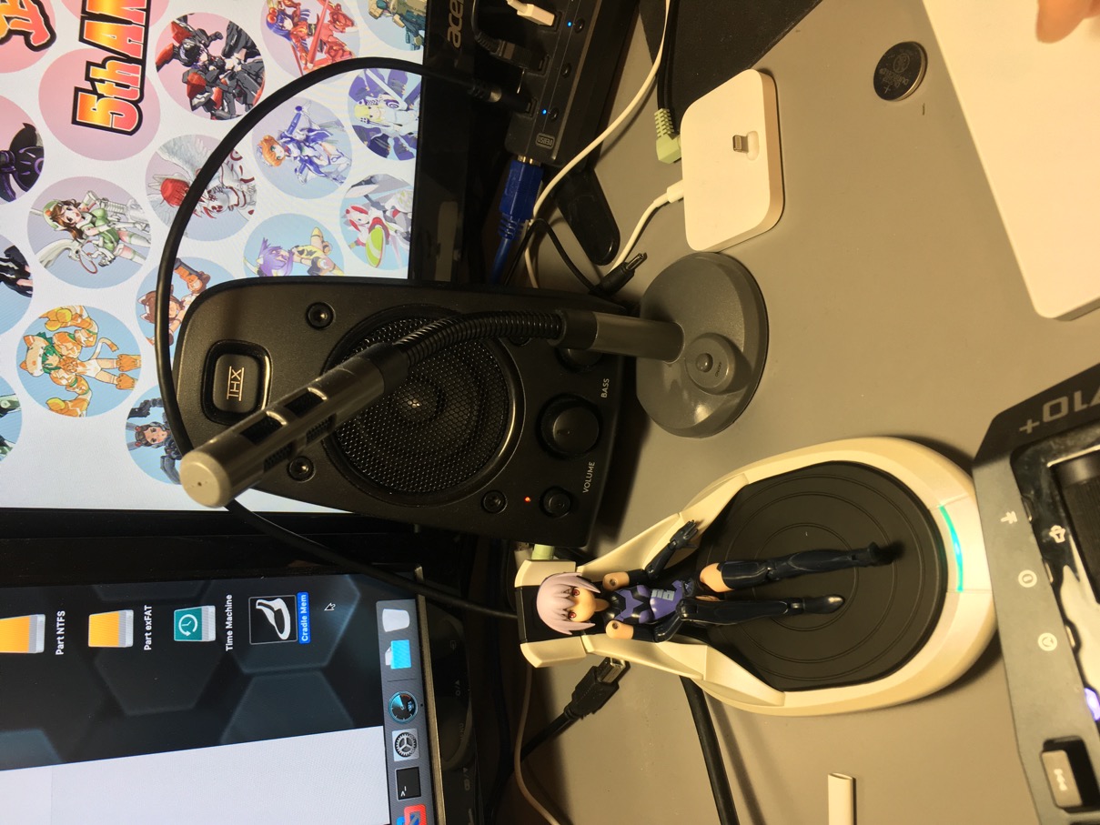

Hello guys,
Here are i0nNepgear and his shinki Ariel. Recently Ive got a nice cradle for her, which she likes a lot and also cost me a leg. But, it's kind of useless, becuz it literally just lit up when you plug it into ur computer. It occupies a USB port but does nothing useful (for me at least), like someone occupies the washroom without taking a dump. So, I decided to make it more useful--by putting an SSD into it. I'll talk about the steps later, but first here's a photo the finished product and Ariel lying on it:

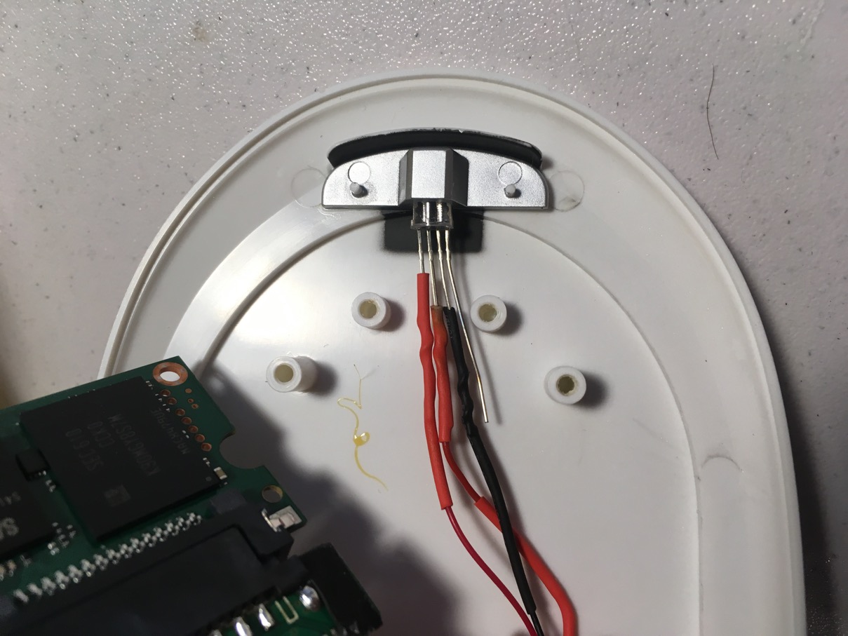

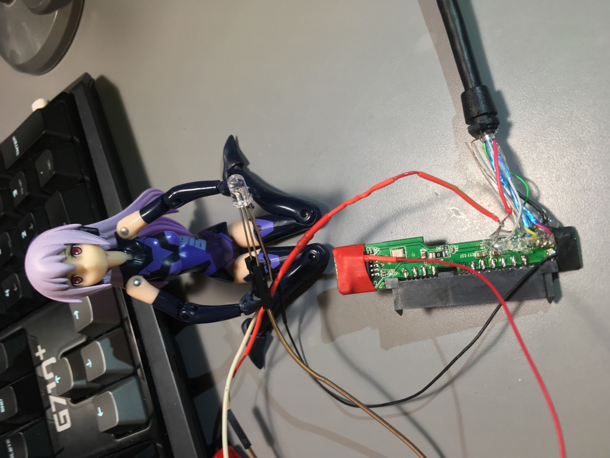

In this photo, you can see how I connect my wires. Note that resistor wrapped in the heat shrink tube. That wire connects the green pin of my LED to the USB power. Another red wire without the resistor connects the blue pin to the anode of the removed mini onboard LED, used as the status indicator. And the black wire connects the common cathode pin of the LED to the USB ground.

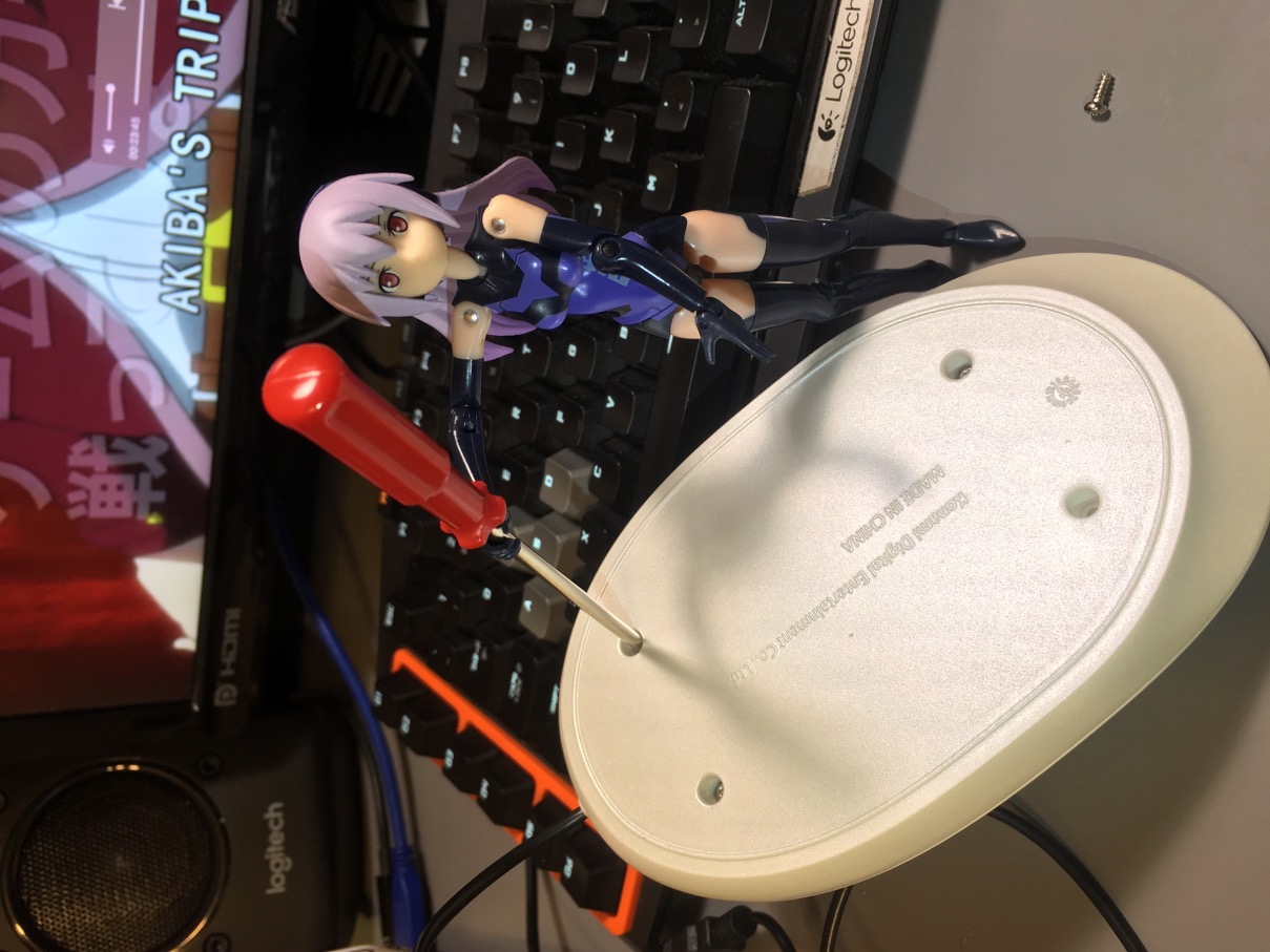

Postby i0nNepgear » Fri Feb 24, 2017 3:57 pm

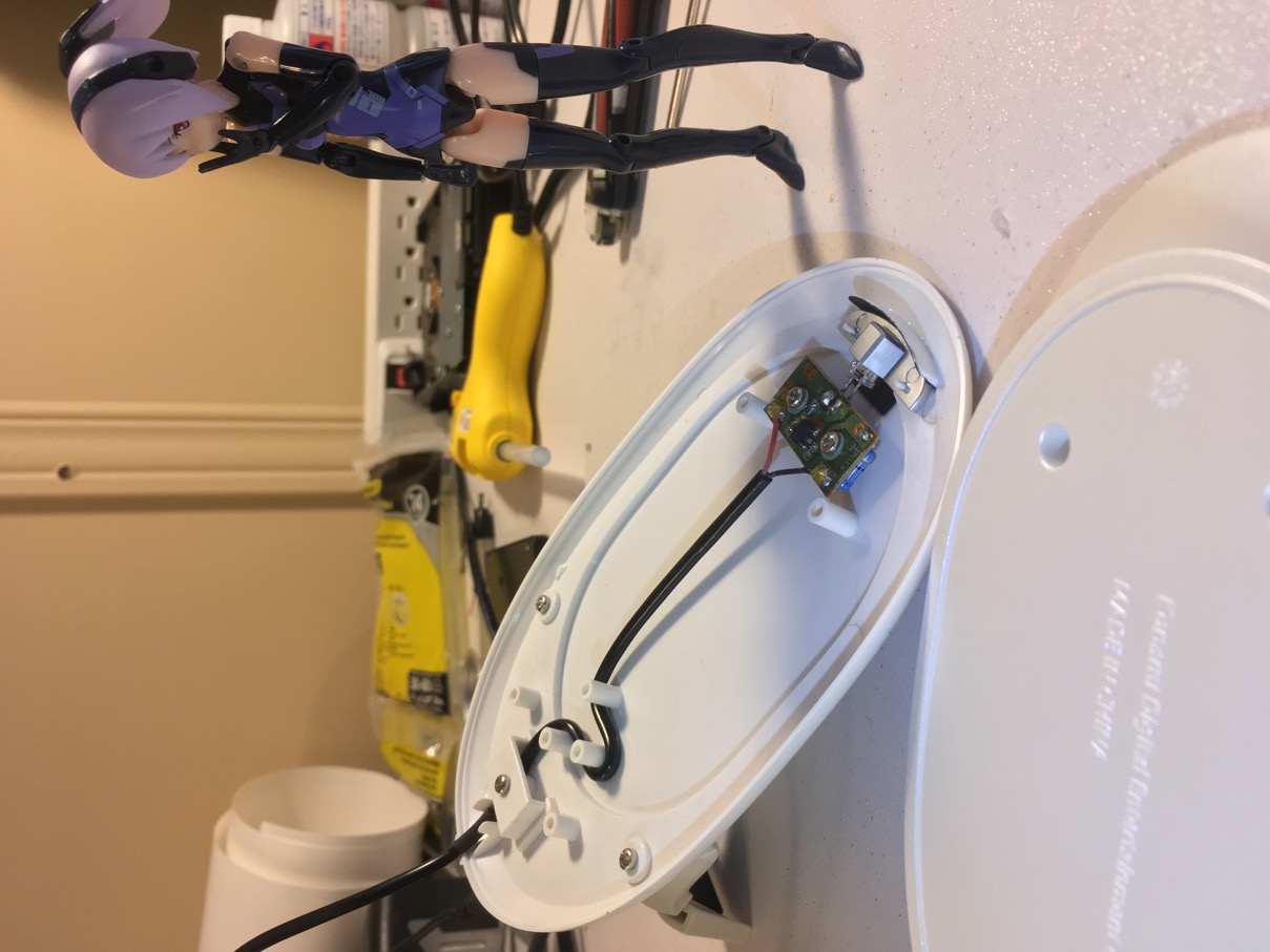

After you get all your things ready, it's time to start working!
First, disassemble the cradle and remove the wire and the small PCB. Cut the LED off the board if you need it.

Re: Cradle modification complete
Postby i0nNepgear » Fri Feb 24, 2017 4:04 pm
Ariel: Oh, so that's everything in my cradle!? ((((;゜Д゜)))
Me: It's just a light, what were u expecting?? ╮( ̄⊿ ̄")╭ I'm thrilled it actually has a small piece of PCB in it. And DON'T TOUCH MY HOT GLUE GUN, it's HOT!! Σ(゜ロ゜;)

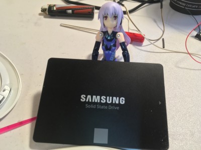

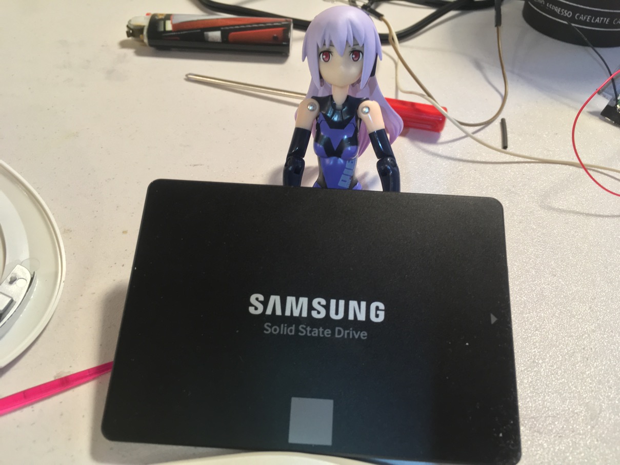

Postby i0nNepgear » Fri Feb 24, 2017 4:07 pm
Next, you need to (crack) open your SSD and take the PCB out of the case. Remember doing this will void the warranty.

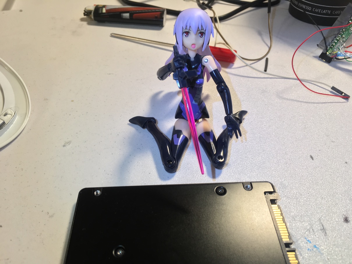

Postby i0nNepgear » Fri Feb 24, 2017 4:13 pm
With the help (force, actually) of her, the SSD was opened (safely).
NOTE: BEFORE you touch the PCB, you MUST ground yourself. You don't want to kill your SSD (which costs u 200 bucks) with electrostatic discharge (aka ESD).

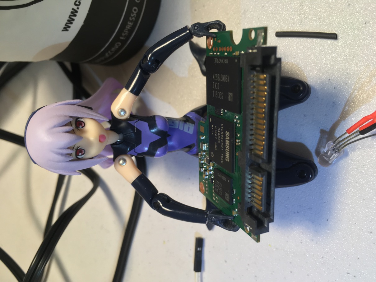

Postby i0nNepgear » Fri Feb 24, 2017 4:26 pm
And here is the PCB inside the SSD case. While I think it's so small, Ariel doesn't think so.
Ariel: Master, how much stuff can u put in this huge (?) thing?【・ヘ・?】
Me: *Look at the manual* 250 gigs, actually formatted capacity less. ヘ( ̄  ̄;ヘ)
Ariel: That's rubbish... The storage inside me is nearly 4TB! ( ̄へ ̄)
Me: Well you're from 2040, what do you expect from technologies that are more than 20 years old?? (ಠ_ಠ)
